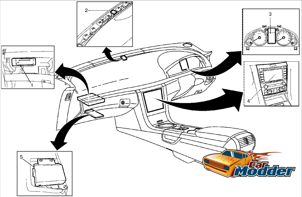

Postby ZerOne » Fri Oct 28, 2011 9:20 pm
GPS Component Locations
14571
(1) Navigation Module
(2) Global Positioning System (GPS) Antenna
(3) Instrument Cluster Centre Multi-function Display
(4) Infotainment Unit
(5) Navigation Interface Module (NIM)

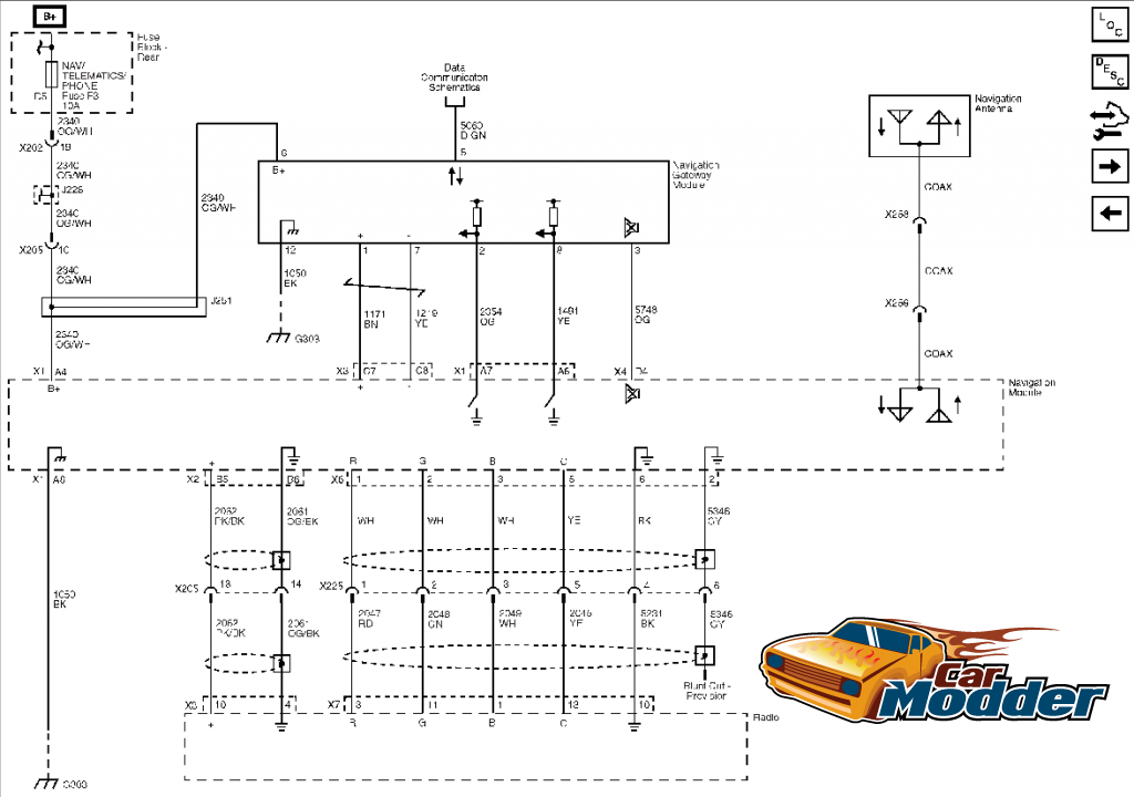

Wiring Diagram
14574
