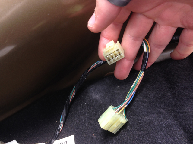

Well.. I think its the trailer harness.. I cant see any other reason for this 8pin plug with reverse wire going to it other then for trailer, might need to take a picture of it!

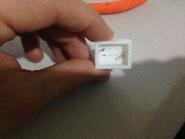

Soo.. the trailer plug..
And my proto 3D printed plug...
It fits!.
Just got to extend the top so it clips into the socket, and also extend the back and thats the plugs sorted!
Will have to do until I can find the proper mating plug :lol:
