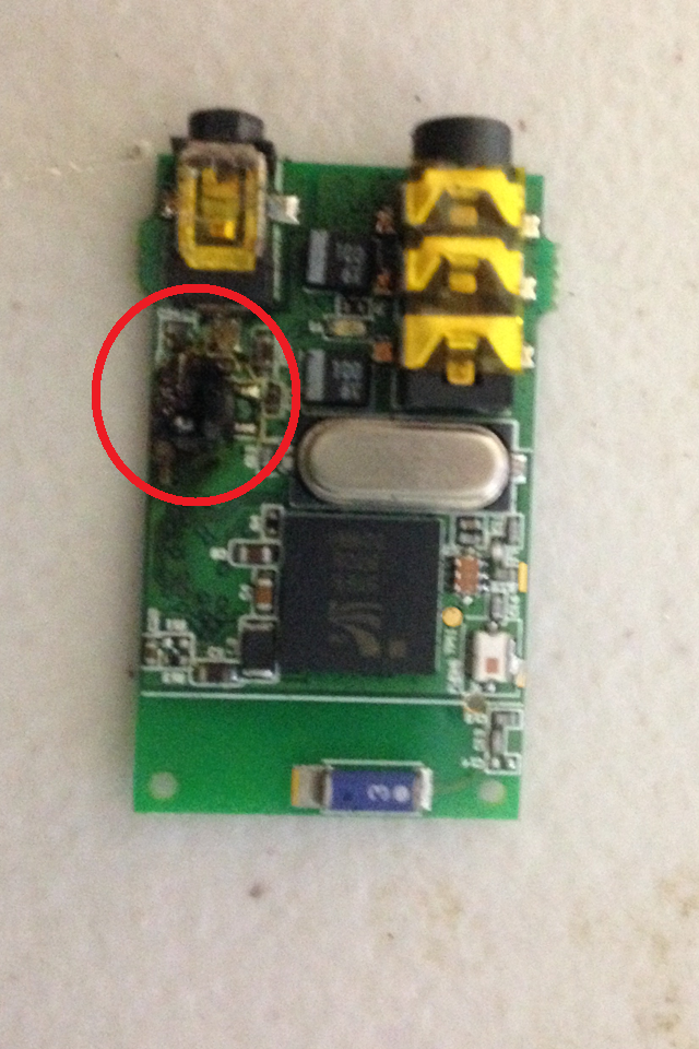

Can anyone guess what happens when you forget to put the voltage regulator down from 14v to 5v? :lol:
This was going to be inserted inside the headunit... but... its a tad cooked now.

Postby Robertau » Thu Feb 04, 2016 7:39 pm
TazzI wrote:Can anyone guess what happens when you forget to put the voltage regulator down from 14v to 5v? :lol:
I really dont need to guess, i know what happens!
You let that magic blue smoke out that smells really rancid, that makes electronics work. :lol:
