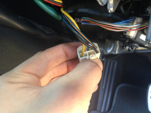

Right! So while I had the ignition barrel out.. I saw this little plug up in there.. not connected to anything.. any ideas??
Also tried to locate where the hell the Aux plug connector is.. its literally non existent! :lol:
I know its got a plug connected to it so Im also looking for the little looped wire that enables the aux.. but I see no plugs that match this.
Ill grab a picture now of what I see...

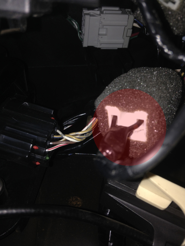

Postby TazzI » Tue Mar 01, 2016 1:22 pm
So I think those two plugs are the phone connector.. 4pin and 2pin connectors there.
Annnnd... I didnt notice this plug before as its wrapped in foam.. but appears to be 6pin.. and its looping in on itself on one of the pins. I think tats the Aux plug..
