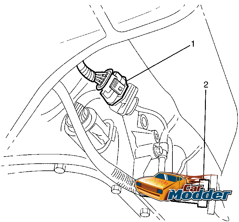

•Disconnect the left post-catalytic converter heated oxygen sensor (HO2S) electrical connector (1).

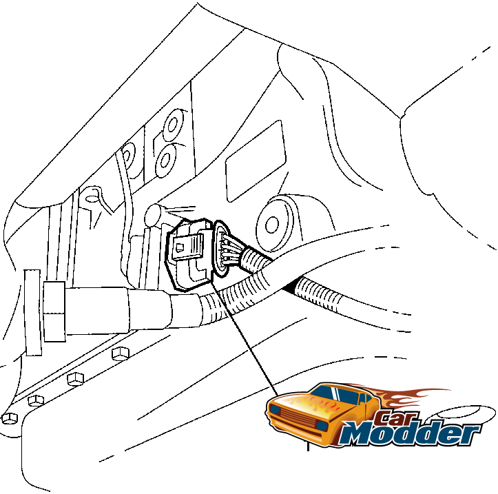

•Disconnect the right post-catalytic converter HO2S electrical connector (1).

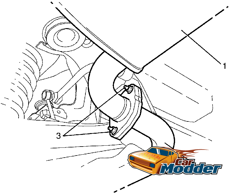

Important: The intermediate exhaust assembly to left catalytic converter retaining nuts (3) are single use parts. They must be discarded after removal.
•Remove the intermediate exhaust assembly to left catalytic converter retaining nuts (3).
Discard the nuts.
•Disconnect the intermediate exhaust assembly (2) from the left catalytic converter (1).

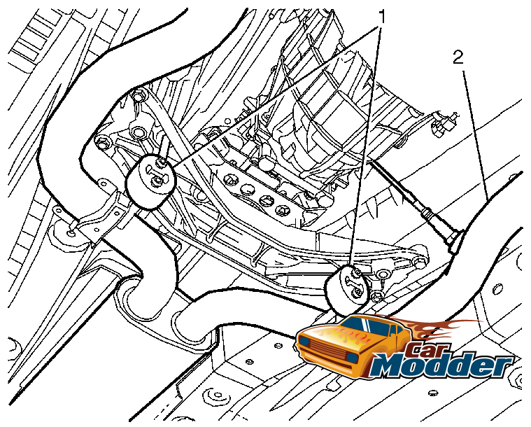

•Detach the intermediate exhaust assembly (2) by removing the front insulator hangers (1) if fitted.

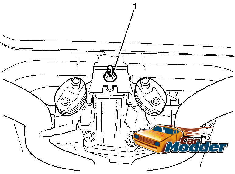

•Detach the intermediate exhaust assembly (2) by removing the centre insulator hanger bracket to differential retaining bolt (1).
•Carefully lower the intermediate exhaust assembly from the vehicle.
